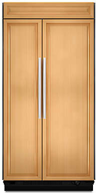

  • A REFRIGERATORS LOOKING SIMILAR TO ONE OF THESE
  • Dacor Models
    • EC3JHAXRL
    • EF42DBSS
    • IF4842
    • IF48NBO
  • Jennair Models
    • JB36NXFXLW
    • JB36SSFXRB
    • JF42PPFXDB
    • JS48PPDUDB
  • Kitchenaid Models
    • KBFC42FSS
    • KBFO42FTX
    • KBLO36FTX
    • KSSC36FTS
    • KSSC48QTS
    • KSSO36FTX
    • KSSO48QTX
    • KSSS42QTW
    • KSSS48QTX
  • Kenmore Maytag Sears Models
    • GC3NHAXVA
    • GC5NHAXVQ

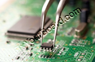

  • A CONTROL BOARD THAT LOOKS LIKE THIS
    • Main Control

    7. Pack and ship the main control board to Fixyourboard.com for a rebuild which includes complete functional test to ensure the re-manufactured circuit board is perfect. Follow the Shipping Instructions here.
